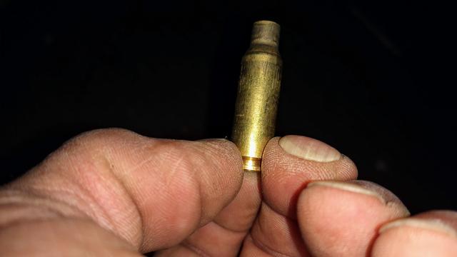

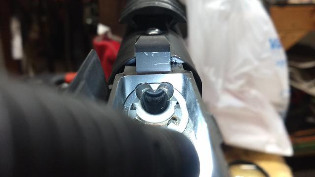

My problem was easy to see on the first cleaning. There was a ring of debris in the throat shoulder area.
Indication on the first shot was indicated on the brass as a sandpaper look that left the impression of the debris.
The indication was rough and looked like possible a bad reamer or some machining metal left in the chamber and then run thru the heat process. The indication was of a hardened state. I considered removing the indication but it was a no brainer just to sent it back. Also noted was a possibility of some of the indication as the bullet would make the jump at the first of the riflings. Also the brass had scratched marks running with the throat of the brass. That indication may have been the ramps.
THE crown was a fair machined surface. Being I have face and crowning tooling I am picky on crowns. I did not bother with the crown after arriving at a miss in the chamber. The gun shot just fair but I never made it past 45-50 yard getting it on paper. Fair at 45 is not great.
The replacement came out the gate showing grouping and after break in the barrel is doing as it should as long as I do my part, this is still at my 45-50 yard mark. Moving out to the 100 yard mark hopefully this week. Depending on the results at 100 yards, if pleased I'll move it out to 200 yards. Again I am no AR15 Expert!
The replacement still needed a cushion on the shell deflector to stop the mouth neck dinging. This is a fixed stock with the rifle buffer and spring and a rifle length gas block. Non adj block for now. The replacement has no indications on the brass that are not normal IMO. Crown looks very good on this one. I know if I bore sight the bore I'll find some areas that will not appeal to me. As long as it groups at 100 - 300 yards I'll be happy. Everything past that will be in me the gunner.

#75
Pics:
[Image: IMG-20190121-124014826-2.jpg]
[Image: IMG-20190121-123813519.jpg]
Look close at the end of the throat. It appears as a gray area in the picture but was a rust color. I may not have explained this area as it should but it's there. Thanks
