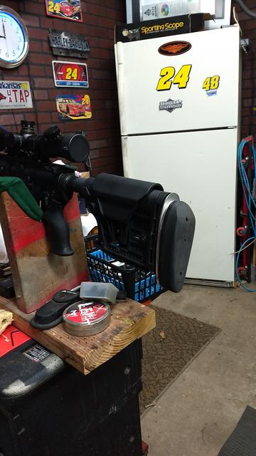

Here is are recoil helper and a much better shoulder fit. I had this SPS adjustable butt adapter with the Kick Easy magnum butt pad
left over from another gun. It was hand fitted for the other gun. The foot print does not match the butt of the LR and is aluminum. Matters not the cosmetics. It's close and when dropped down it blends in.
Rain and wind today. No shooting!
