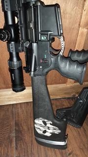

I have not yet fired it, unfortunately, the weather has been less that conducive to shooting anything and my membership to the local outdoor range hasn't been renewed yet in any case - doing that soon just in case the weather does take a turn for the better...
Parts list:
- BCA 20" complete upper with fluted barrel
- Anderson unmarked lower
- Odin Works LPK
- Odin Works rifle buffer/tube/spring kit
- LuthAR MBA1 adjustable stock
- Monstrum Tactical 6-24x50 G2 scope
- C Products Defense 6.5 Grendel 26rd SS Magazine
[ATTACH=CONFIG]13803[/ATTACH]
[ATTACH=CONFIG]13804[/ATTACH]
[ATTACH=CONFIG]13805[/ATTACH]

Nice, Let us know how it shoots.
Reply
Good looking rig!
If you don't mind me asking, seeing how you said "El Cheapo"...how much was that butt stock?

CaptnC Wrote:Good looking rig!
The stock was the most expensive single part besides the BCA upper - which was the primary part I was referring to as El Cheapo Wink. It runs around $130 pretty much everywhere I've looked. it feels great and is very solid even though it's pretty light weight.

Cereal Thriller Wrote:Curious about the scope, was going with a Vortex 6-24x but every place locally is sold out. See a few places online and they all want more money. Supply and demand I guess.
Let us know its pro's and con's please.
I will update as I get a chance to get some range time - working on test loads using 3 different bullets and powders (IMR4895, W748, and BL-C2) while waiting on weather. So far, just scoping about and comparing it to my Bushnell AR223 Dropzone 4.5-18x, the glass is very clear at 24x with only very very mild edge distortion at 6x which clear by 12x. It's a first focal plane scope also.
