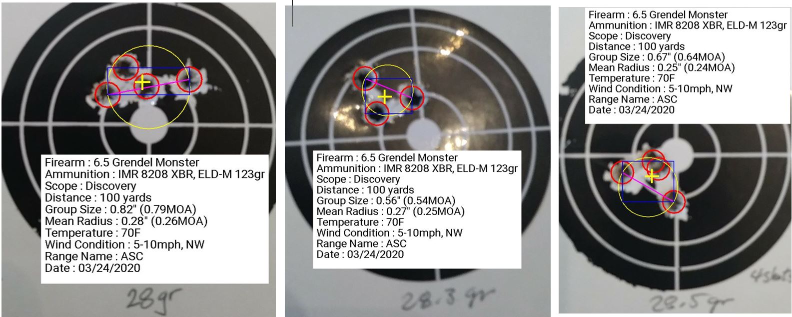

Well, I can't say how thankful I am that all of you talked me into reloading. It really is a blast and look at the results of my first outing with my Grendel rounds.
![[Image: Reloaded65G.jpg]](http://www.martinsen.com/65Grendel/Reloading/Reloaded65G.jpg)
![[Image: Nosler-HornAmGunNiceGroups.JPG]](http://www.martinsen.com/65Grendel/Reloading/Nosler-HornAmGunNiceGroups.JPG)

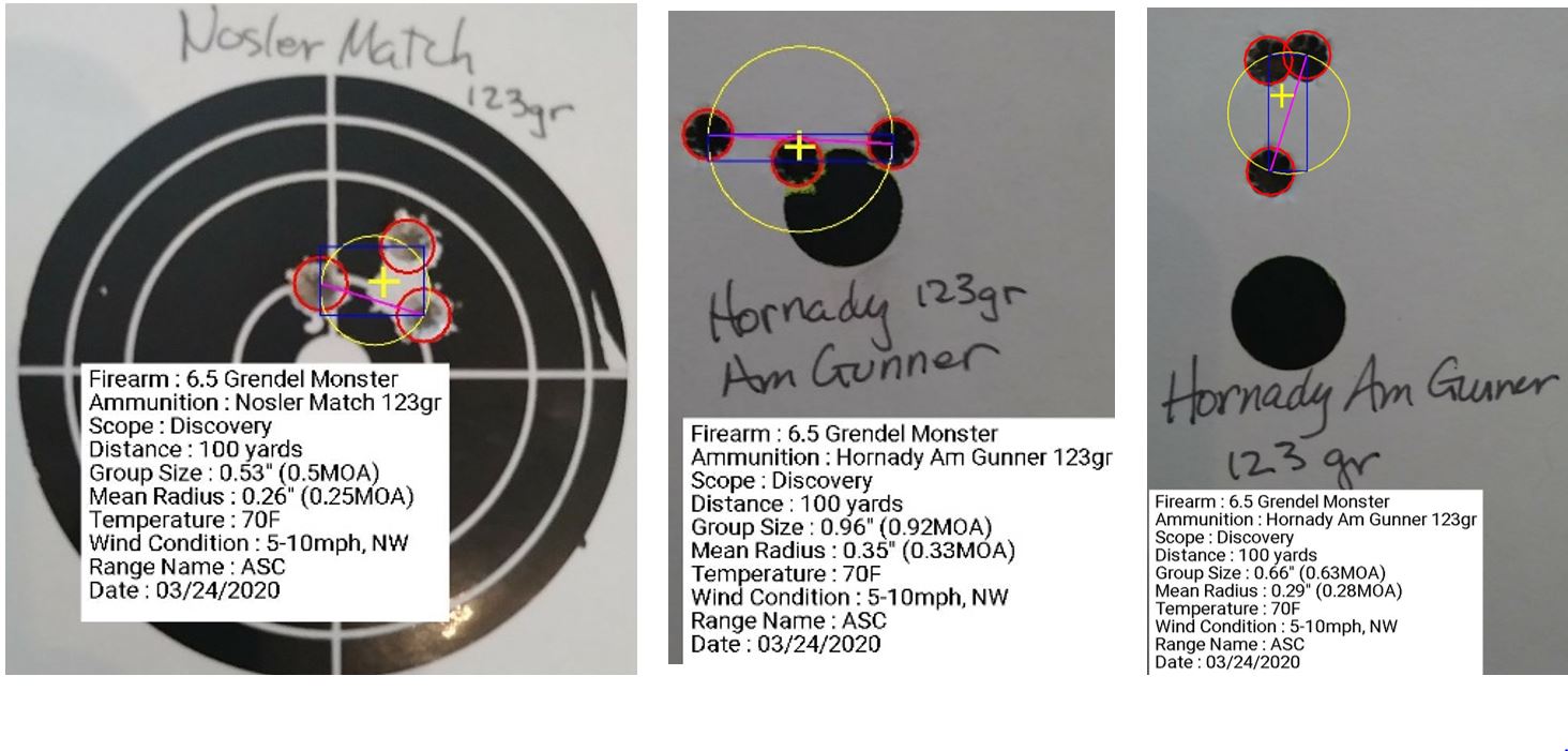

I had some decent groups with other charges, but those around the sweet spot of 28.5 did the trick.
I was using IBR 8208 XBR with Hornady ELD Match 123gr and brass from previously shot Hornady American Gunner bulk ammo.
This was my first go round just to see how my own rounds would shoot, and they all shot great! I can definitely do better, but this brought me to another entire level when it comes to my hobby of firearms! It's a lot of fun and have great results already - and I'm expecting only to improve! And this is with an AR semi-auto. Can't wait to see what happens when I shoot with my bolt action 243 and 6.5 Creedmoor! (once I save up for those dies!)
I also got good grouping with my Nosler Match and Hornady Am Gunner, but not as consistent as my hand loads.
Again, thanks for all the help!
BTW, I really love the Lee Classic Turret - great price, great customer support, easy to use and I'm very pleased with the final products so far.
