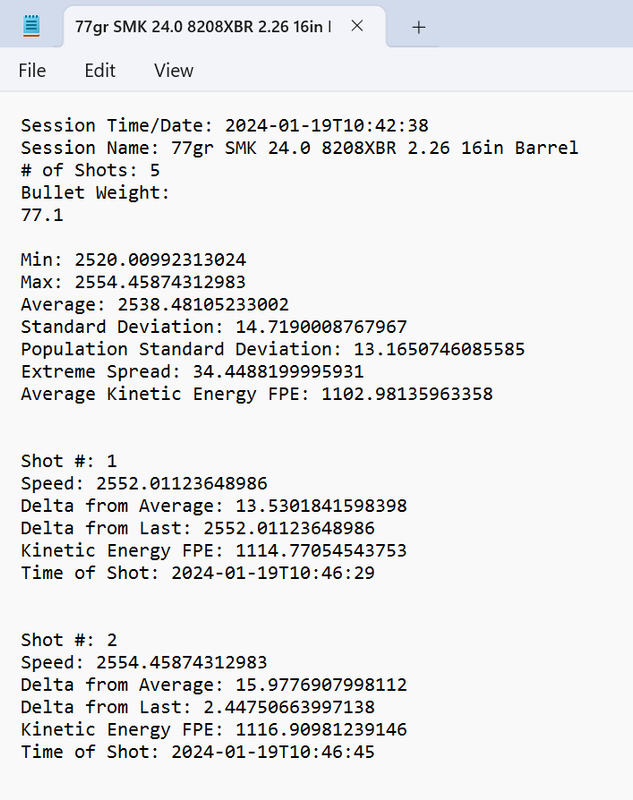

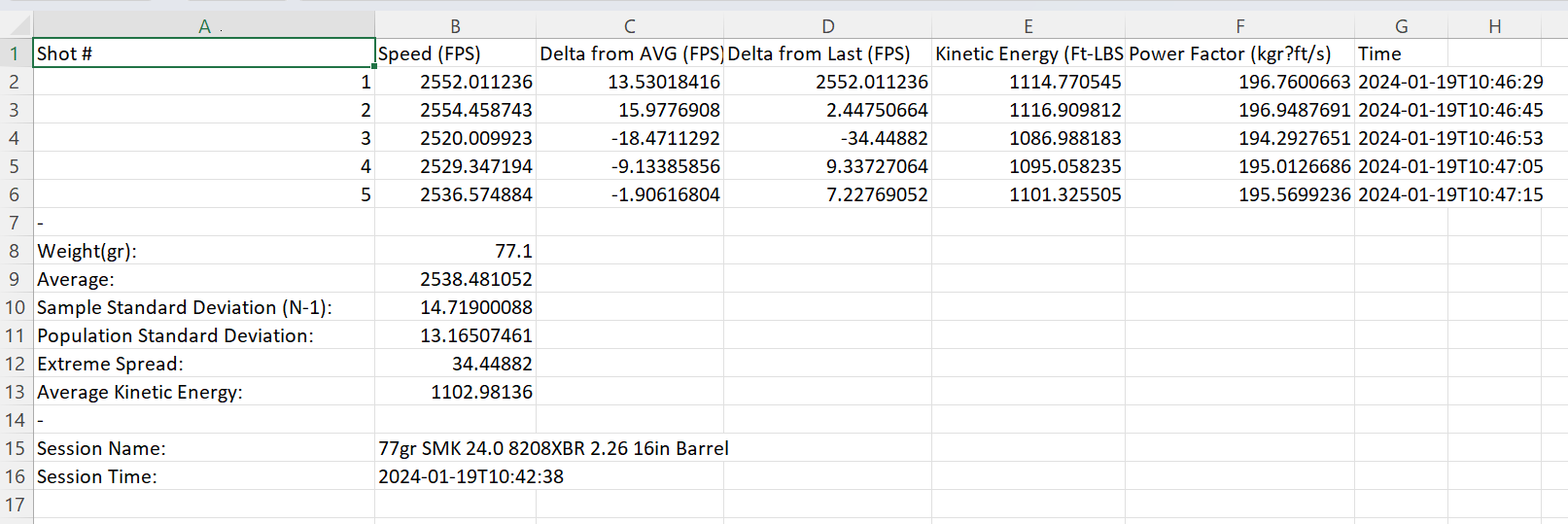

Sample Output
[Image: csv.png]
[Image: txt.png]
