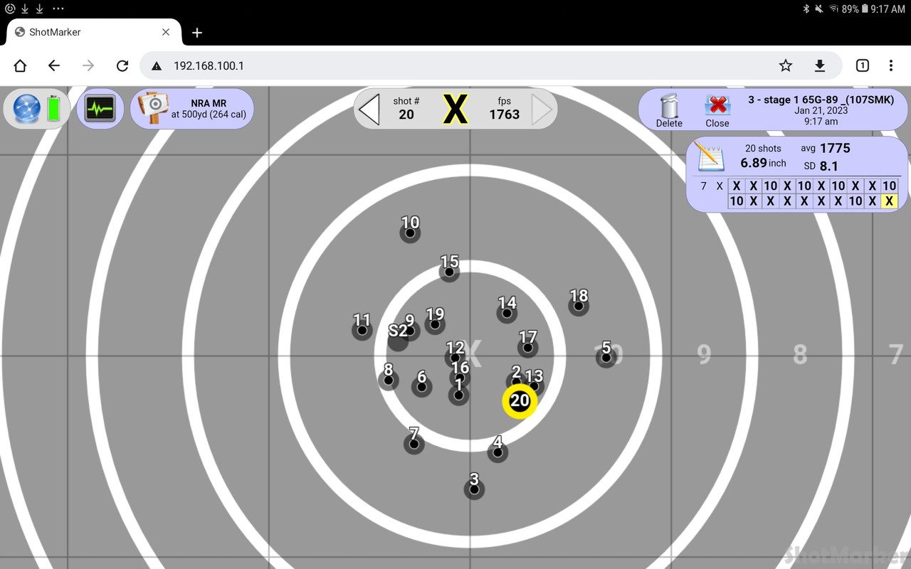

Note that over a course of 20 rounds fired, wind change is a factor, and will sight adjustments tend to be done as you go.
107SMK (my favorite Grendel bullet for this). Impact velocity at 500 yards is: 1775 */- 8. That's moving along pretty good, with a great SD.
[Image: 20230121_-_65_Grendel_20in_Alexander_-_6...107SMK.jpg]
Shoots a clean 200-14x. Very light sight adjustment over this string, ranging from +3.9 to +4.0MIL elevation above my 200 yard zero, and Wind only went from L0.2 to L0.3 MIL. Very light wind with almost no change the string.
