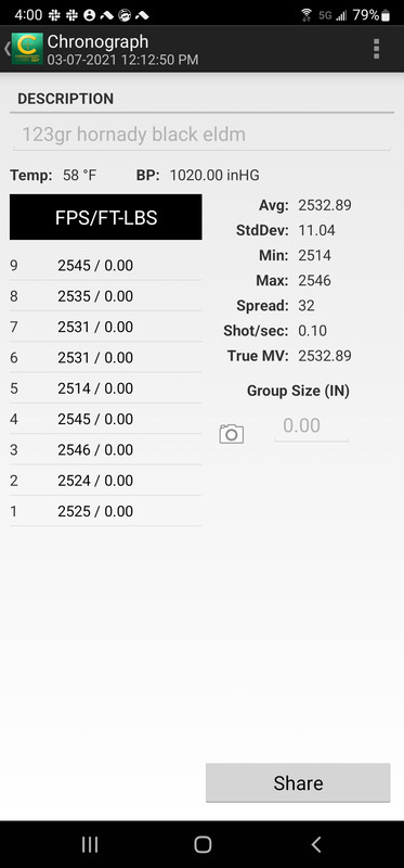

I ran into the same problem when trying to zero in my AR in 6.5. I have an older Black Diamond in an 8x32x54 It also ran out of travel. I thought scope was broke so I sent it back to Burris for a diagnostic and it checked out fine. I bought a Warne 20 MOA mount, and it appears to have remedied the problem. Apparently, Burris scopes don't have the same amount of travel as Leupolds which is the only other brand I have. I got the Burris for a really good deal off a friend who learned the hard way about those Super short magnum caliber and barrel life. Vascar2 you seem very knowledgeable. I dont have a crono and have been shooting Hornaday Black 123 grain I think. What kind of barrel velocities do you think I would get if I put on a 24 inch barrel as opposed to the 20 I am running? Would it make that much difference? I have a 24 on a 5.56 I love.
Ran out of scope travel, Burris AR P.E.P..R mount - Zeneffect - 07-29-2022
Not much.
Here is hornady black 123gr from a 22"
[Image: Screenshot-20220729-160038-Chronograph.jpg]
Ran out of scope travel, Burris AR P.E.P..R mount - VASCAR2 - 07-30-2022
This might help but the trend is pretty clear. These results were from a few years ago on a 70 degree day using a Magnettospeed chronograph, five shot strings.
Difference between 20” and 18” barrel 6.5 Grendel
120 grain PPU HP BT
25 FPS difference
110 grain PPU FMJ
44 FPS
123 grain A-Max
41 FPS difference
123 grain SST
18 FPS
Hand load 123 grain Nosler CC
55 FPS difference
Wolf 100 grain FMJ Steel Cased
44 FPS difference
Velocity Difference 20” compared to 24”
120 grain PPU HP BT
79 FPS difference
110 grain PPU FMJ
69 FPS Difference
123 grain A-Max
63 FPS Difference
123 grain SST
72 FPS difference
Hand load 31.0 grains CFE223 CCI 450 primer 123 grain Nosler CC
93 FPS Difference
Wolf 100 grain FMJ
80 FPS Difference
Hand Load 107 grain SMK 28.5 grains IMR8208XBR CCI 41 primers
71 FPS Difference
I can post the specific results but they have been posted before. In general going from 20”-24” you gain approximately 60-100 FPS higher velocity with the 24” barrel.

Thanks guys. Looks like it probably wouldn't be beneficial enough to spend on a new barrel with only that much of a velocity increase.
