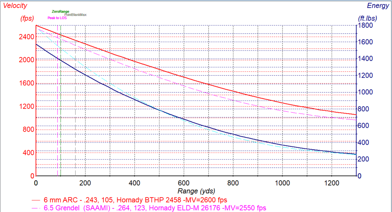

Here is a comparison between 6mm ARC(Hornady 105gr BTHP), 308Win(Sierra 175gr TMK), and 6.5 Grendel(123gr ELDM) that I did in QuickTarget.
These calculations are from QuickTarget and QT Unlimited and therefore I do not know how accurate they are. Just thought it would be interesting to see on a graph.
Update: I decided to use graphs that showed the lines better. I also added the 123gr 6.5Grendel to the mix.
VELOCITY
[url=[Image: velocity100-175-123.png]][Image: velocity100-175-123.png][/url]
ENERGY
[url=[Image: 100-175-123.png]][Image: 100-175-123.png][/url]

jasper2408 Wrote:Here is a comparison between 6mm ARC(Hornady 105gr BTHP) and 308Win(Sierra 175gr TMK) that I did in QuickTarget. The bottom 2 lines are the ft/lbs and they reference to the scale on the right and the top 2 lines are velocity and they reference to the scale on the left. The bottom scale is range which is 1500yds max.
This graph is at 200m elevation(Ukraine), 70 degrees temp and give about a 200ft/lbs difference at 950yds. I also used 110 deg and the 308 increased to 236ft/lb spread. I then tried 20 degrees temp and the lines came within 140 ft/lbs.
These calculations are from QuickTarget and therefore I do not know how accurate they are. Just thought it would be interesting to see on a graph.
Purple line = 6mm ARC velocity - 2600fps starting velocity
Red line = 308Win velocity - 2500fps starting velocity
Blue line = 308Win ft/lbs
Light blue line = 6mm ARC ft/lbs
[url=[Image: 6-ARC-VS-308-WIN168-TMK.png]][Image: 6-ARC-VS-308-WIN168-TMK.png][/url]
That's interesting. Any chance you can throw in basic 6.5 Grendel Hornady 123 gr to compare?
Hornady Team Discusses 6mm ARC - Zeneffect - 05-01-2022
the precise reason i asked how to run the overlays. what speed on the 123? im looking at 2700fps because my gun.
[Image: vel.png]
general mock up without all the altitude corrections. common velocity for 123's
Hornady Team Discusses 6mm ARC - jasper2408 - 05-01-2022
Quote:general mock up without all the altitude corrections. common velocity for 123's
Man I need to start bugging the dev on letting us change the colors of the lines in the QT graphs. My old eyes can't hardly track that light blue line.
Nice comparison though. Closer than I thought they would be.
