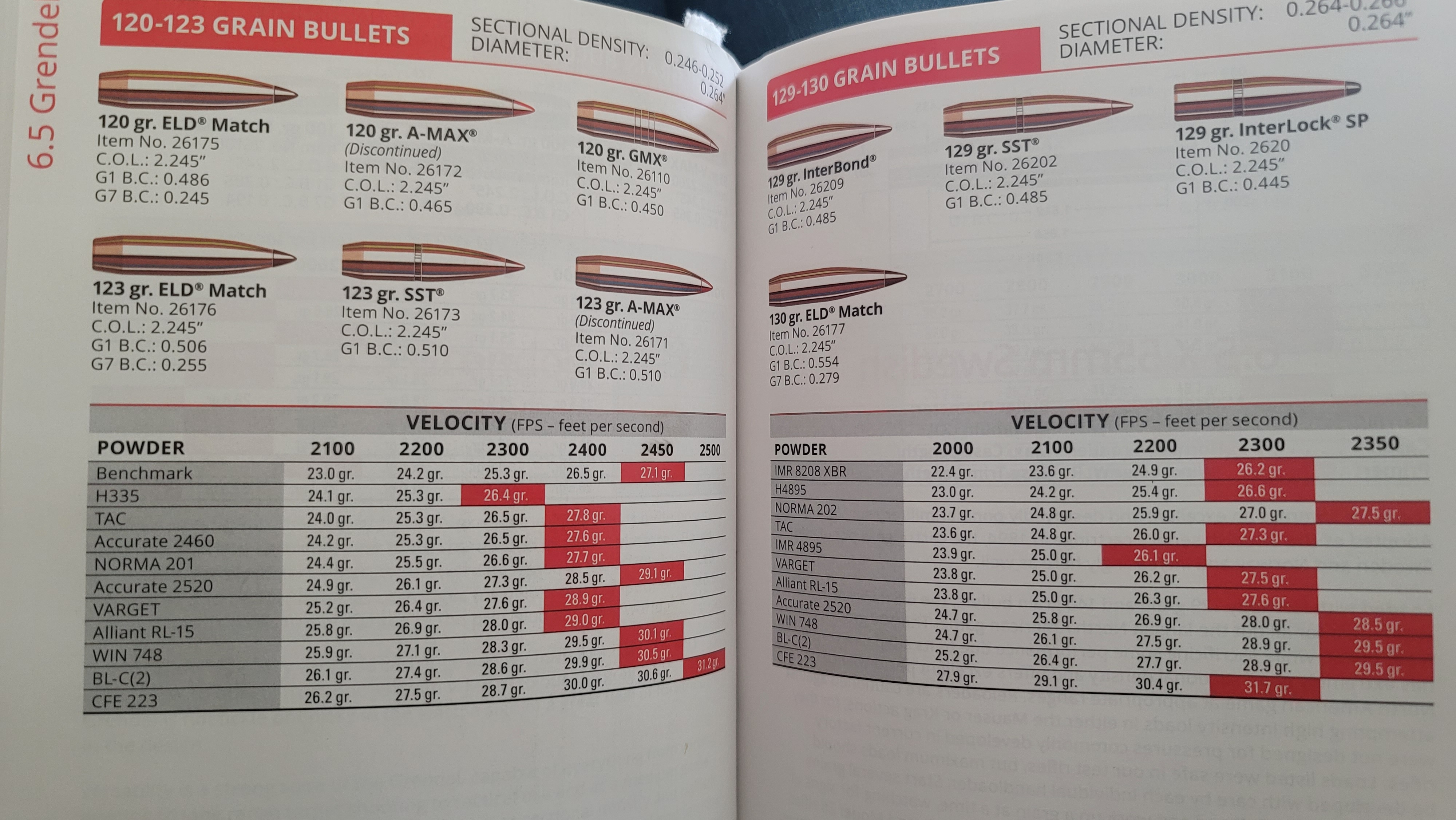

Accuracy Issues - Zeneffect - 02-26-2022
[Image: 20220226-095003.jpg]
