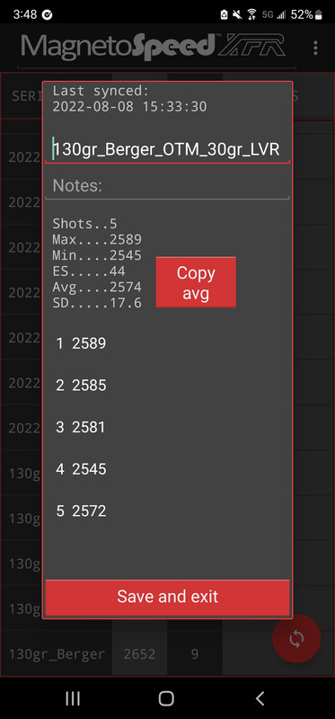

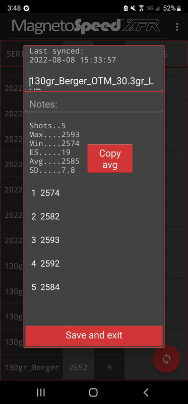

130gr Berger AR OTM + LVR - Zeneffect - 08-08-2022
Fun stuff. I thought maybe I'd see or feel something but nada. Just groups and chrono, nothing out of the ordinary today.
Looks like somewhere 30.9 and 31.2 will be where I'll be fine tuning the charge because SD is acceptable and there seems to be a trend in that area

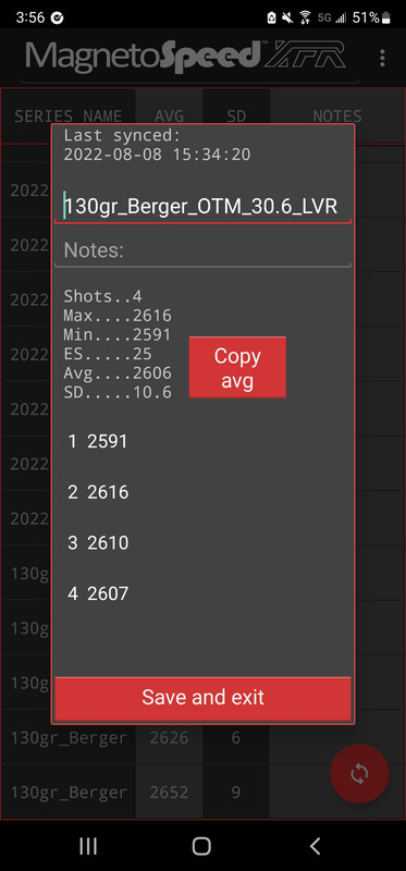

Forgot to hit a button on 1st shot, 4 recorded

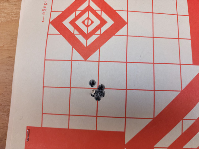

[Image: Screenshot-20220808-154907-XFR-REV2.jpg]
[Image: 20220808-143646.jpg]
Flier is the one to the right, def pulled that one. Other stray holes to the left is where I was sighting in a .223 and can be ignored.

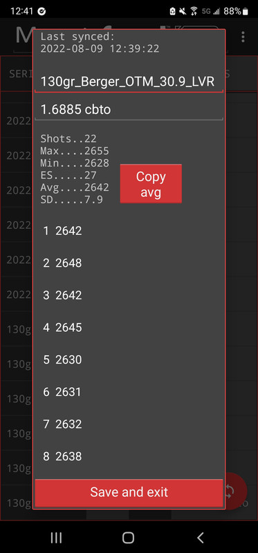

22 more over the chrono today while hammering steel at 550yds to see if single digit SD was a fluke.
[Image: Screenshot-20220809-124148-XFR-REV2.jpg]
