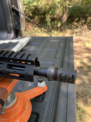

[Image: 20200907114025small.jpg]
Range 100 yards, temp 80-83 deg, shot from prone from back of truck bed off of sandbags.

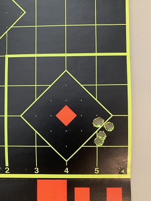

100 gr NBT group 2

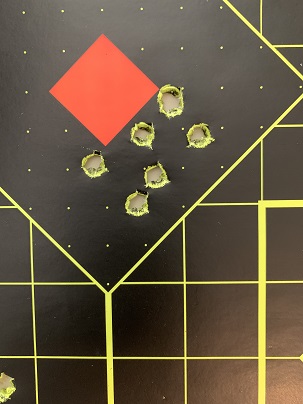

123 AMAX groups. Bottom triangle is 3 shots without suppressor. Top triangle is 3 shots with suppressor. Slight POI shift about 0.5" up and right.
