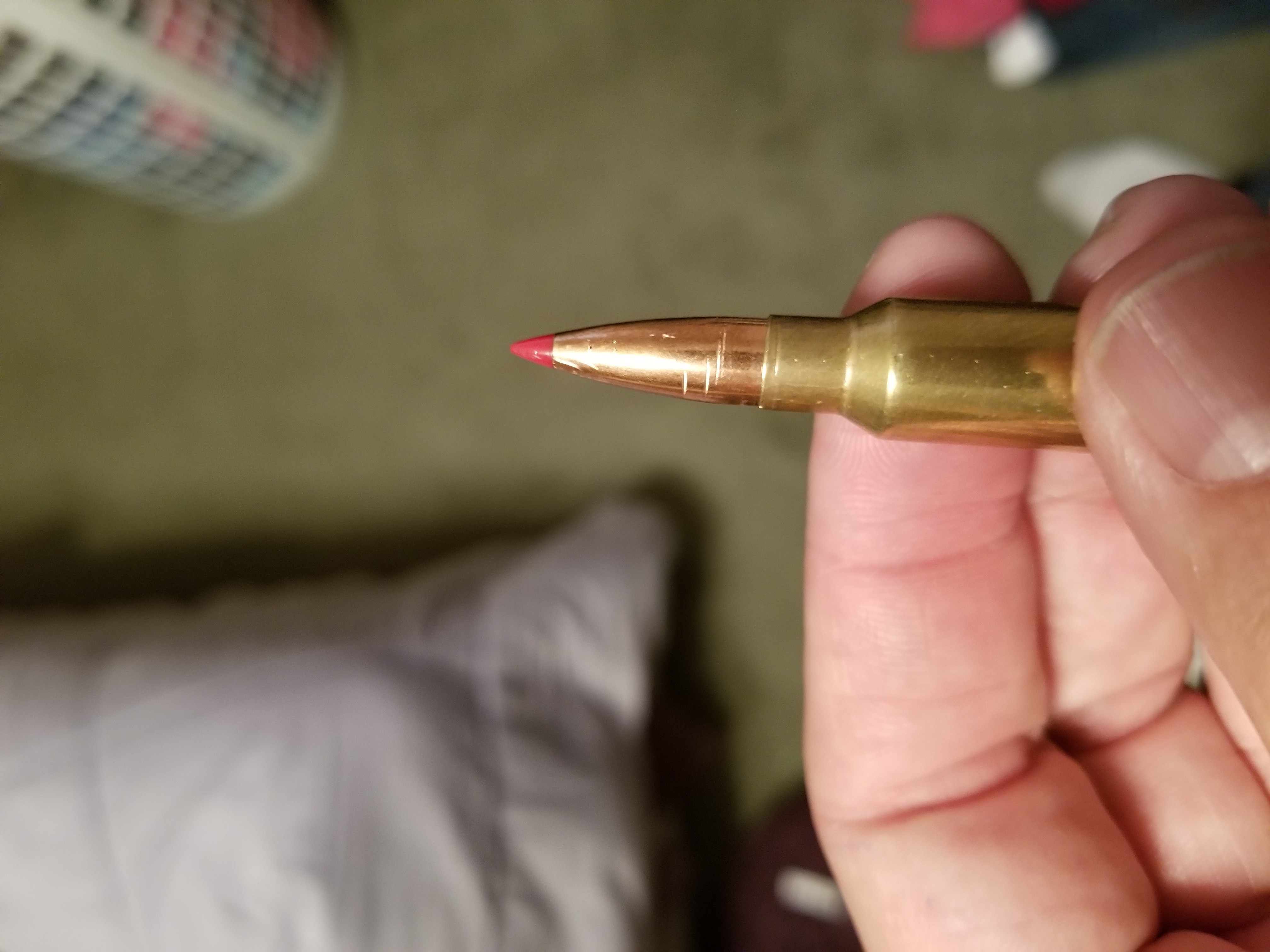

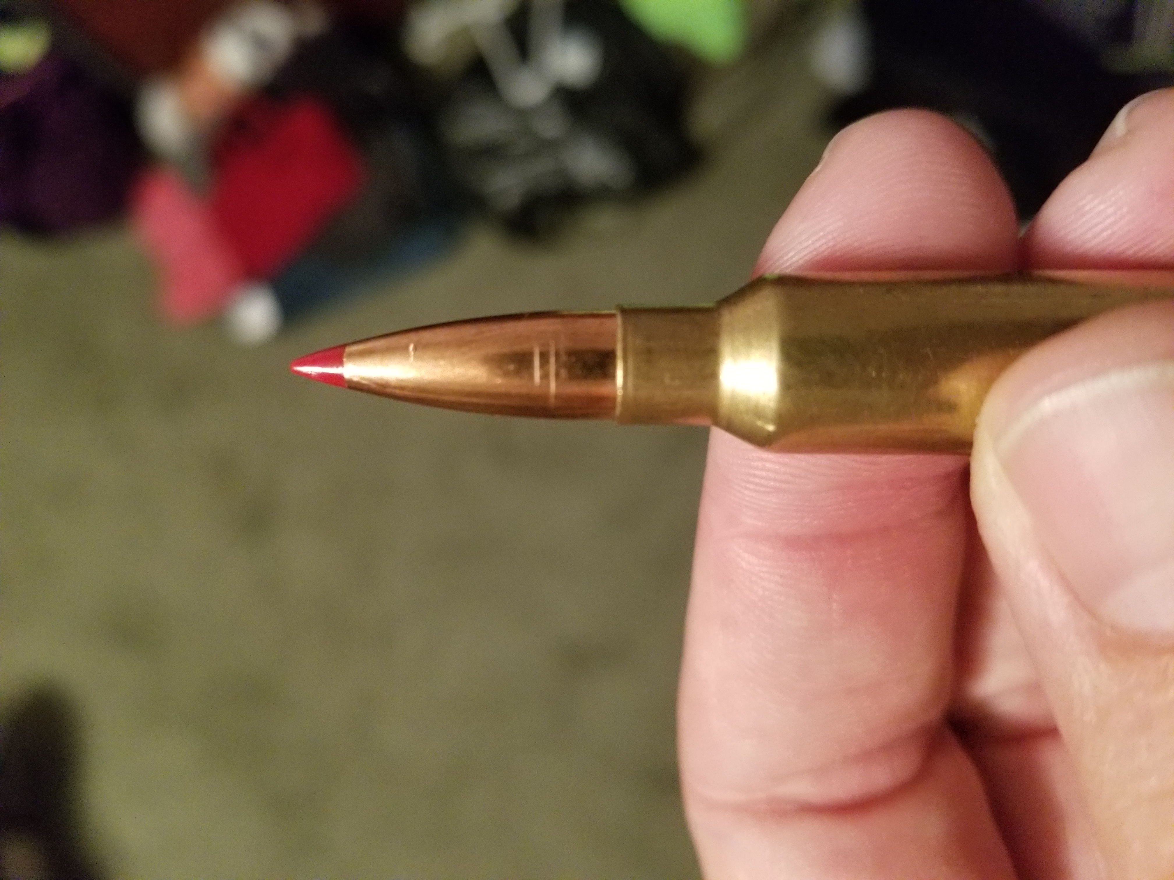

I am hoping someone can help. I am not even sure its a big deal, but I am trying to get a sub moa group, and the scratches may very well be one factor in not acheiving that goal. Its a new build, 20" BCA barrel, AA upper, DPMS lower. The feed ramps on the barrel lug line up with the upper.

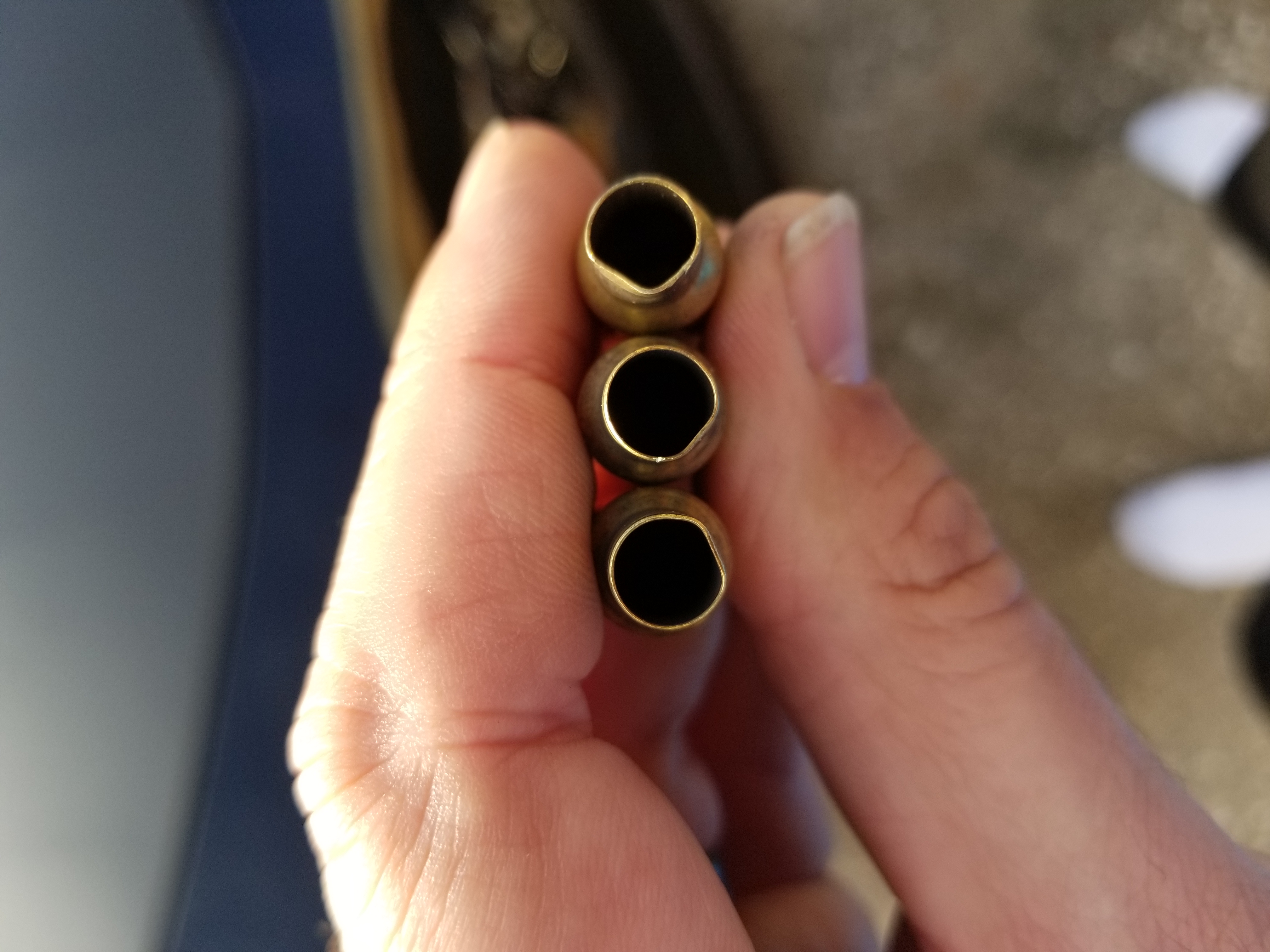

I also have dinged cases, and I adjusted the gass block to "perfect". I suspect heavy extractor spring. Not really a big deal, but it would be nice to eliminate.
I will add the pics when I can. Apparently I cant on the mobile site.

How many scratches?
If only 2 then it could be sharp edges on the extention.
If more like the same amount of the rifles bore then it could be the rifling.

I dont think its the rifling, I should be 0.08 off the lands. It could be 2 spirals though, and they are well past the ogive, almost to the case neck... would polishing the feed ramps help?
The dings I was mentioning are on the neck, in case it was not clear.

siconic Wrote:I dont think its the rifling, I should be 0.08 off the lands. It could be 2 spirals though, and they are well past the ogive, almost to the case neck... would polishing the feed ramps help?
It couldn't hurt for sure.
Dents in the case neck could be from the case hitting on its way in to the chamber, maybe double check the rounds are feeding smoothly from the mags your useing.
Spiral scratches on bullets? - siconic - 11-24-2018
The dents in the neck I think are from the brass deflector on the upper. Not 100%, but there is brass color on the deflector as well. I think its "over extracting" and really throwing that brass out.
The spiral scratches on the bullets, so close to the case necks, could that be from the feed ramps? Just seems so weird to me for some reason.
Spiral scratches on bullets? - Bigs28 - 11-24-2018
Case necks hitting the extractor and denting is normal. You can put a soft pad on the deflector if you want to minimize it but i don't worry about it and let my resizing die take care of it.

I wouldn't worry about those dents in the case mouths... heck I've dropped brass after sizing on my garage floor and it did that. I just run it back through my sizing die and they turn out fine.

What could be causing those scratches though? I am just OCD, so if I can eliminate them, I would like to. BUt I cant imagine at 100 to 300 yds it would, but what about out to 700?
Spiral scratches on bullets? - Sticks - 11-25-2018
I'd take a hard long look at the throat. Looks like a burr or something scoring the bullet when the bolt goes into battery.

siconic Wrote:What could be causing those scratches though? I am just OCD, so if I can eliminate them, I would like to. BUt I cant imagine at 100 to 300 yds it would, but what about out to 700?
out of curiousity can you try to get a pic of the chamber/barrel extension area?
I'm also curious what mag you're using?
Spiral scratches on bullets? - grayfox - 11-25-2018
Those look circumferential, not spiral, the "spiral" had me confused... seems to me they could come from excess nitride-nubs (burrs) inside the throat, scratching during the bolt lockup, not during insertion. There has been some recent history of nitride-artifacts from some mfrs, scratching up cases/bullets.
