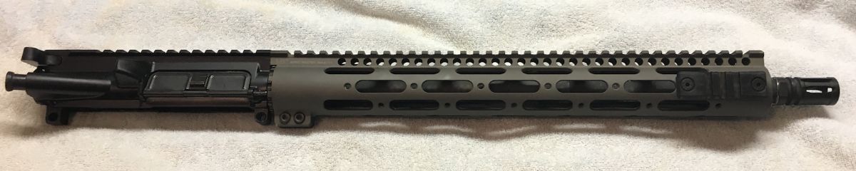

I believe this is my first post so please go easy on me. I am looking at a 6.5 Grendel upper to add to my S&W M&P Optics ready AR15 and am wondering if this is a good one to get and what issues might I run into? I am looking at spending $400 on this. Please see description and pic below.
Thank you,
Bill
Pre-owned in like new condition: 6.5 Grendel: Complete Anderson upper, 16" M4 profile 1/8 twist, PSA Premium bolt carrier group, and OD green Midwest Industries 15" rail.
[Image: 290802.jpg]

For starters, I'd want to know who made the barrel, and which chamber specification? And, which bolt is in the PSA BC, they dont make Grendel bolts to my knowledge.
And who is selling it, close friend? Or......god forbid, an individual at a gun show who wants cash?

The 6.5 Grendel is all about precision shooting so the barrel is the most important part. Everything else is just window dressing.
Is this a good Complete Upper? - IescapedCali - 01-14-2018
Welcome to the forum, smokinggun. You've already gotten some of the best advice available, here. While that may seem like a good way to get a Grendel at a budget-friendly price, there are some questions that need verifiable answers before you hand over your hard-earned dough. It might turn out to be a great value, which makes everyone else jealous of your good luck in picking it up at a great price, or it might torn out to be a couple of good parts with some junk attached. The barrel is going to be the biggest reason you make tiny cloverleaf holes in a bullseye, or it looks like you shot at the target with granddad's shotgun. It's also the one part of that package that isn't given any provenance in the description. Keep your $ until the important parts check out. You'll be happier, later.

The barrel is Anderson 16" 6.5 Grendel 8 twist, that's all he knew about it.
The Bolt came from 65Grendel group buy, I guess here on the forum.
I think I will be keeping an eye on Bear Creek Arsenal to see what comes back in stock. I am hoping for a 20" SS 8" twist barrel rifle gas length. I'm not in a hurry, so I guess that's a good thing.
