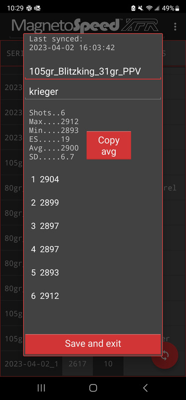

Starting to play with this in a 28" barrel
It's getting interesting. Pushing it harder doesn't result in much more fps, suspect burnout a bit too far before muzzle exit resulting sub-optimal velocity gains. Guess I need to try the all mighty leverevolution with the extended barrel length I'm playing with.
