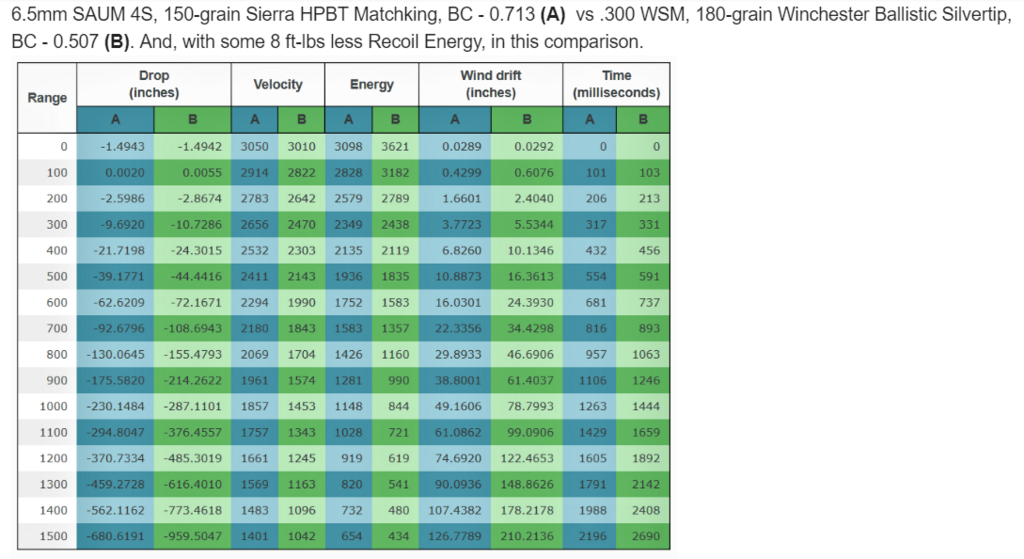

Re Recoil Energy: The 6.5mm SAUM 4S has 28% less than the .300 WSM, in this comparison.

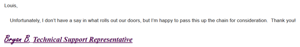

Broken 6mmAR Bolt - SHORT-N-SASSY - 07-23-2019
And, today's response from CMMG:
[Image: Bryan-7-22-2019.png]

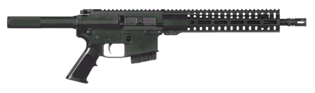

CMMG Pistol, Banshee 100, MKW-15 6.5mm Grendel, 12.5" barrel ---
[Image: CMMG-Pistol-Banshee-100-MKW-15-6-5mm-Grendel.gif]

And the answer I received from CMMG Tech Support, yesterday, "Yes, the MKW does."

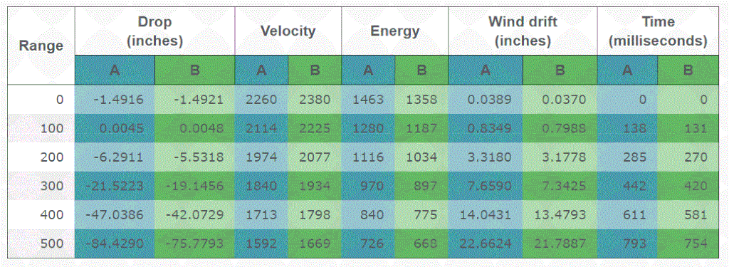

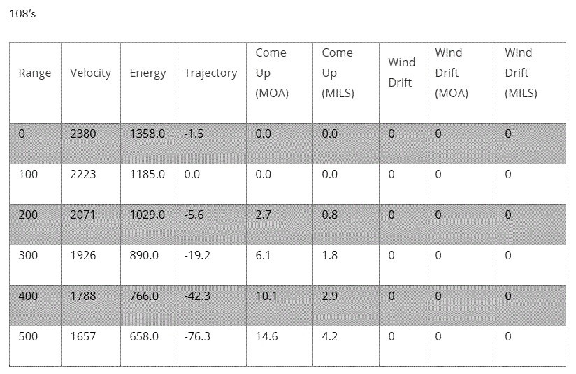

Using the gundata.org Ballistic Calculator, dialing-in the respective muzzle velocities from 12.5" barrels, I compared the 6.5mm Grendel (A) loaded with the 123-grain SST projectile (BC - 0.510) against the 6mm ARC (B) loaded with the 108-grain ELD Match projectile (BC - 0.536) up to 500 yards ---
[Image: 6-5-Grendel-vs-6mm-ARC-A.gif]

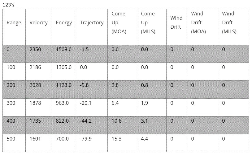

Broken 6mmAR Bolt - SHORT-N-SASSY - 09-04-2020

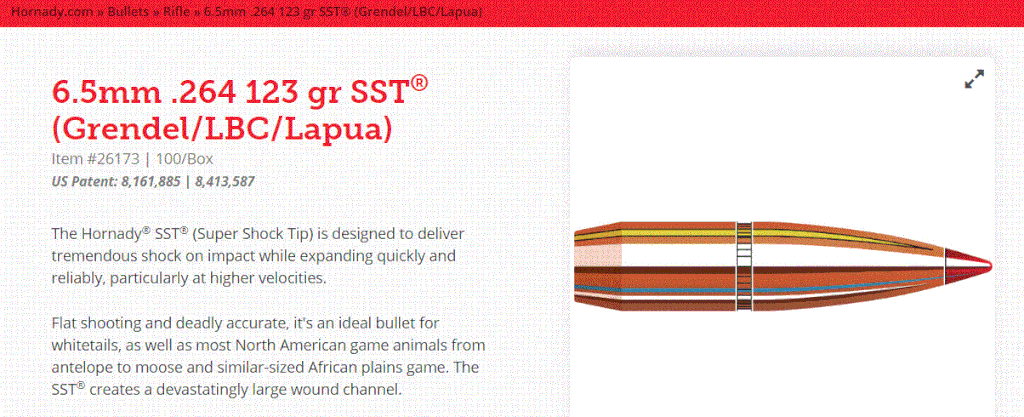

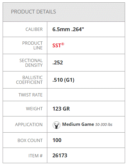

[Image: 8-5mm-123-grain.gif]
[Image: 6-5mm-123-grain-A.gif]
[Image: 6-5mm-123-grain-B.gif]
http://www.hornady.com/bullets/rifle/6-5mm-264-123-gr-sst-grendel-lbc-lapua#!/

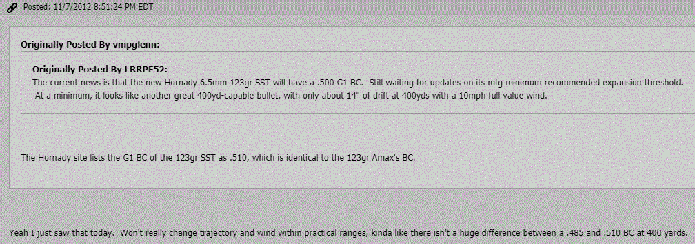

Broken 6mmAR Bolt - SHORT-N-SASSY - 09-05-2020
[Image: LRRPF52-A.gif]
http://www.ar15.com/forums/ar-15/New_Hunting_Bullets_for_6_5_Grendel/121-589531/#i5708853

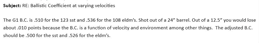

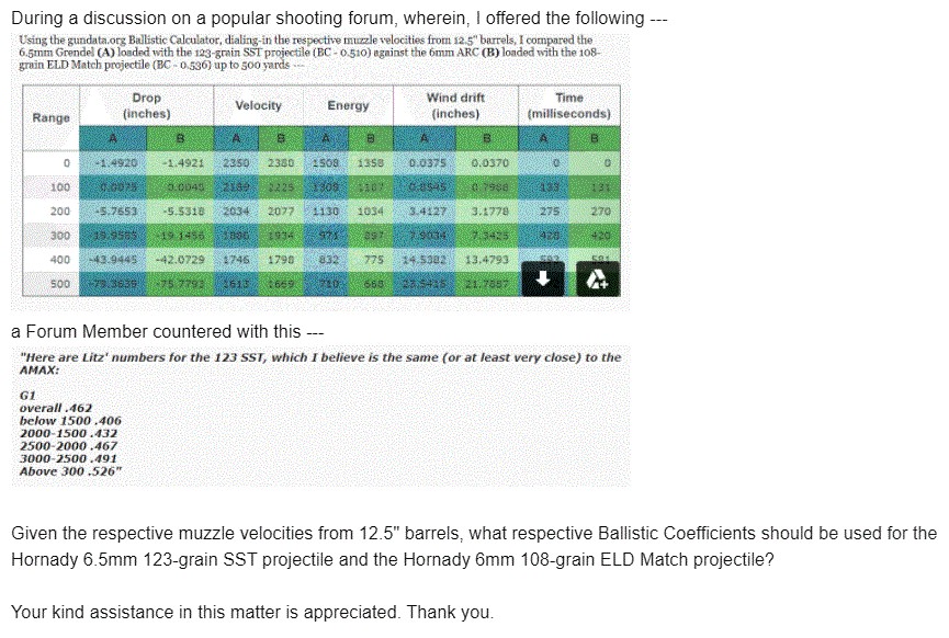

I today sent the following email-request to Hornady Manufacturing Co. ---
[Image: To-Hornady-9-5-2020-2.jpg]
Broken 6mmAR Bolt - Mad Charlie - 09-06-2020

The following compares the 6.5mm Grendel (A)123-grain Sierra MatchKing, Ballistic Coefficient (G1) - 0.522, muzzle velocity (12.5" Barrel), 2420 fps, with the 6mm ARC (B) 108-grain Hornady ELD Match, Ballistic Coefficient (G1) - 0.536, muzzle velocity (12.5" Barrel), 2380 fps, to 500 yards, w/ 10 mph crosswind ---
[Image: 12-5-6-5-G-123-MK-v-6-ARC-108-ELD.gif]

I today received the following response from Hornady Manufacturing Co. ---
[Image: Hornady-9-8-2020-3.jpg]
[Image: Hornady-9-8-2020-A-3.jpg]
[Image: Hornady-9-8-2020-B-3.jpg]

And, then, there's the Hornady 6.5mm Grendel 123-grain ELD Match Hornady Black factory load: BC - 0.506 (G1).
All in all, I think it's fair to state that the Bryan Litz Report was an eye-opener, a whole new ball game for extended-range shooters.

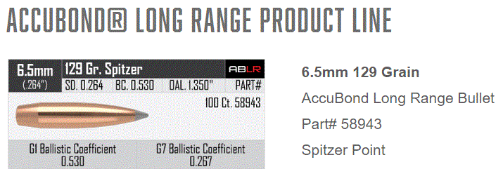

And, the Nosler 6.5mm ABLR gets high marks on this Forum
http://www.65grendel.com/forum/showthread.php?16967-12-5-quot-Group-Buy-Barrel-129-ABLR-VS-Hog-DRT&p=193445&viewfull=1#post193445
Comparing the 6.5mm Grendel (A) loaded with the 6.5mm Nosler ABLR 129-grain projectile, BC - 0.530 (G1) against the 6mm ARC (B) loaded with the Hornady ELD Match 108-grain projectile, BC - 0.536 (G1), from 12.5" Barrels, up to 500 yards, with a 10 mph crosswind ---
[Image: 6-5-G129-ABLR-vs-6-ARC108-ELD.gif]

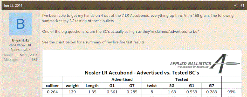

The Ballistic Coefficient used for the Nosler ABLR 129-grain in my last Post was based on this information ---
[Image: 129gr-Accubond-0-530.gif]
< http://www.nosler.com/accubond-long-range-bullet >
i've since come upon the following:
[Image: Litz-Nosler129-0-553-BC.gif]
< http://www.longrangehunting.com/threads/nosler-lr-accubonds-bc-testing-results.137554/#post-966832 >
I now compare the 6.5mm Grendel (A) with the 6mm ARC (B) substituting the updated Ballistic Coefficient (0.553) for the 6.5mm 129-grain Nosler ---
[Image: Litz-65mm-129-Accubond.gif]

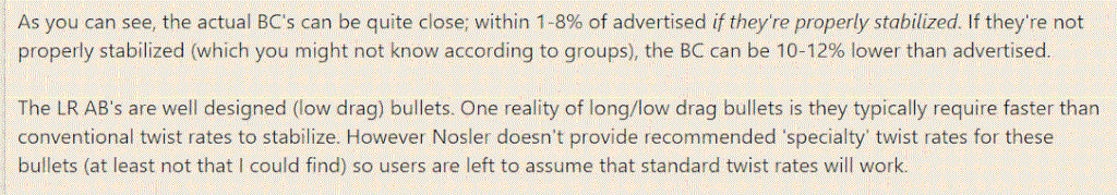

Broken 6mmAR Bolt - SHORT-N-SASSY - 09-10-2020
ETA:
Bryan Litz on the importance of proper twist rates for low-drag bullets ---
[Image: Litz-on-twist-rates.gif]
(See his Post on longrangehunting.com, above)
