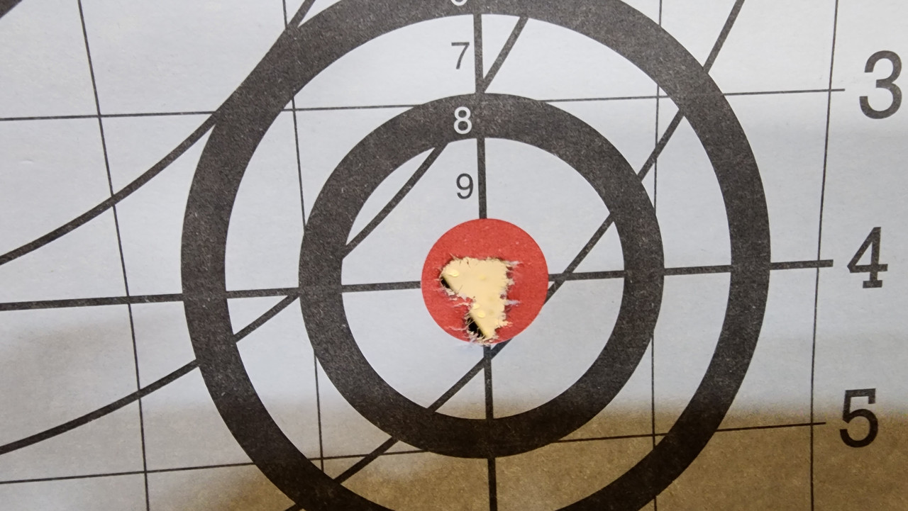

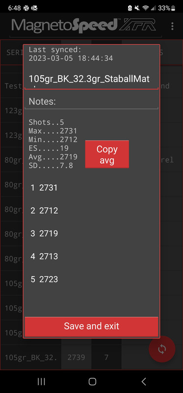

Sierra 105gr Blitzking data - Zeneffect - 03-06-2023

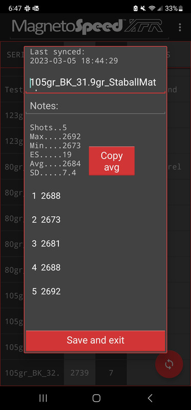

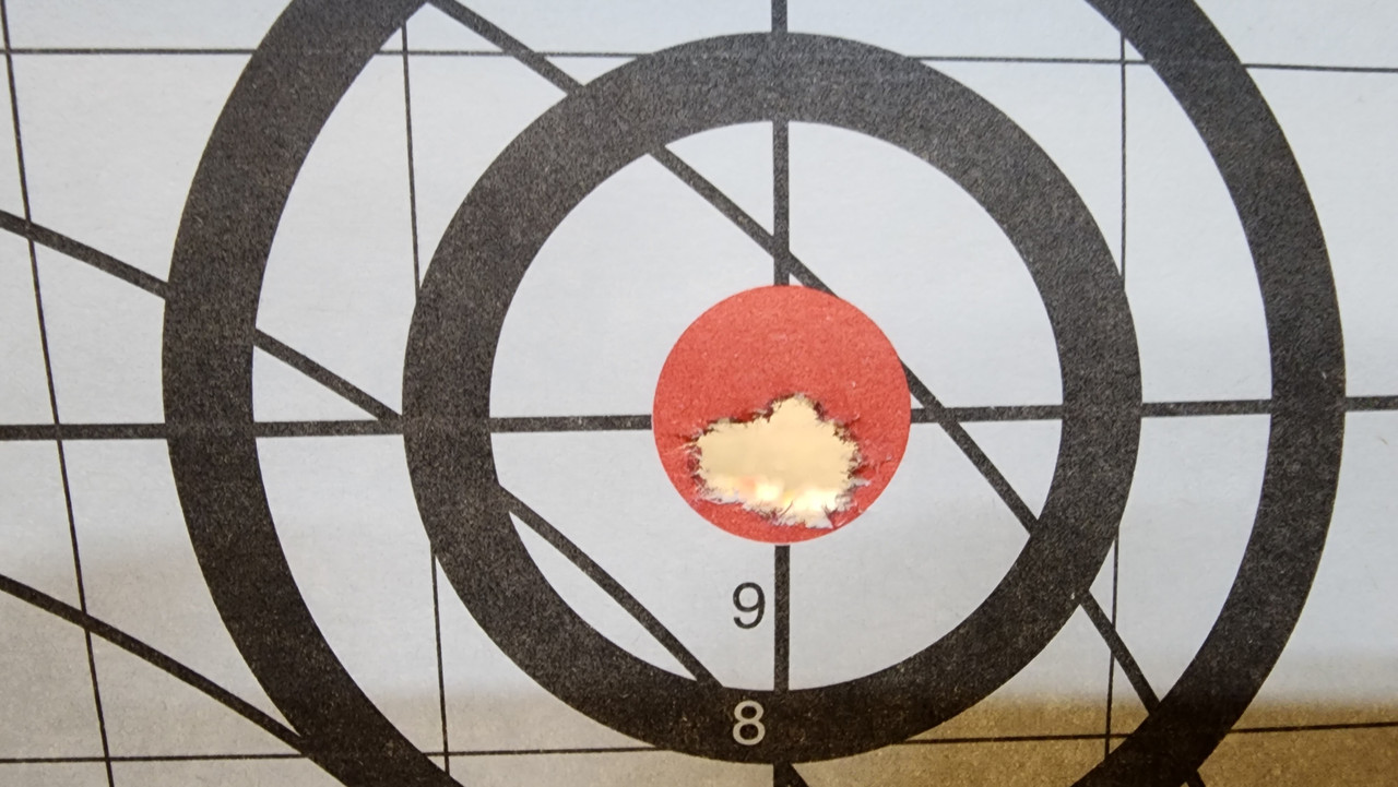

Coal 2.275
Lapua brass
Cci #41 primer
31.6gr Staball Match
[Image: Screenshot-20230305-184751-XFR-REV2.jpg]
[Image: 20230305-174720.jpg]

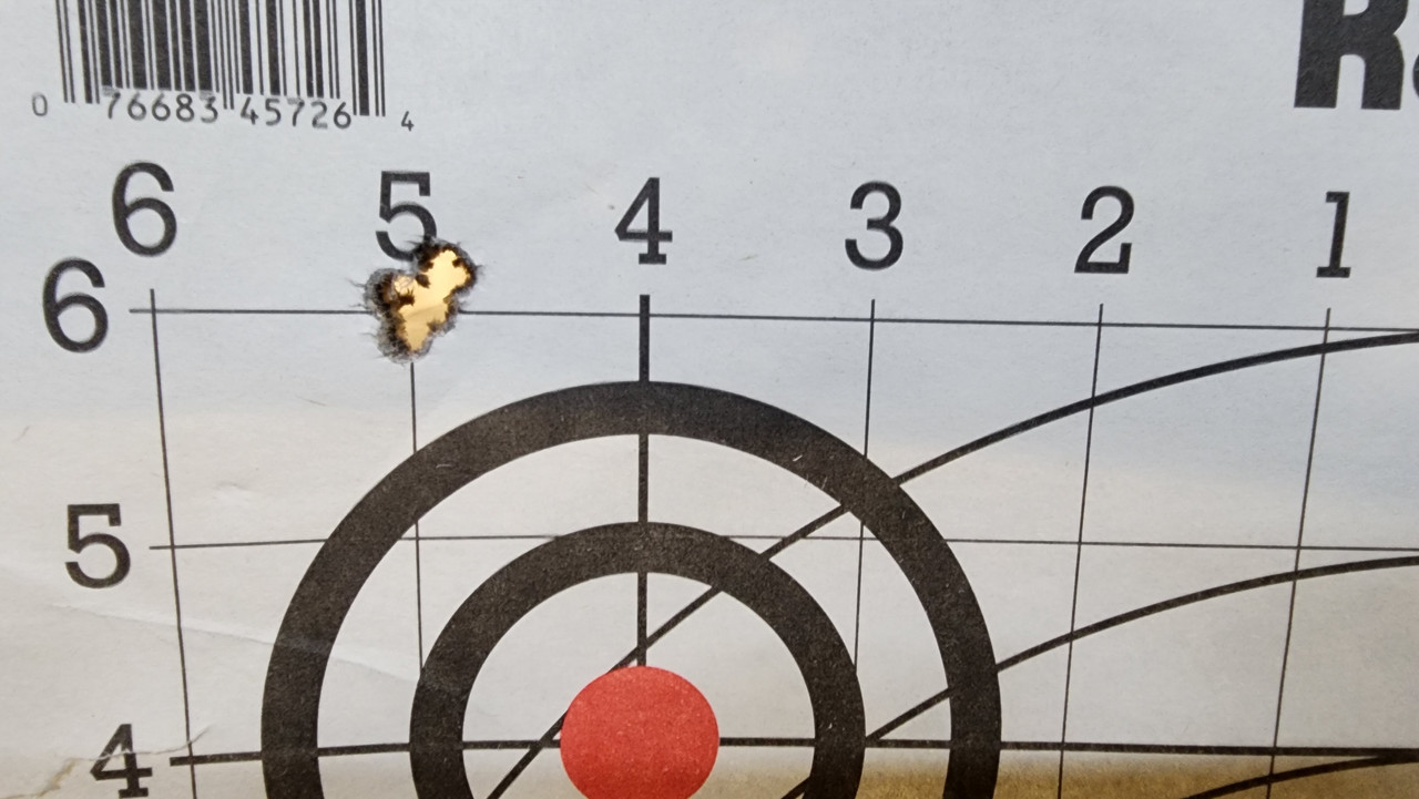

31.9gr (adjusted scope at this point. Did not expect 2 moa high)
[Image: Screenshot-20230305-184757-XFR-REV2.jpg]
[Image: 20230305-174723.jpg]
32.2gr (ignore typo in screen shot, it's really 32.2)
[Image: Screenshot-20230305-184805-XFR-REV2.jpg]
[Image: 20230305-174727.jpg]

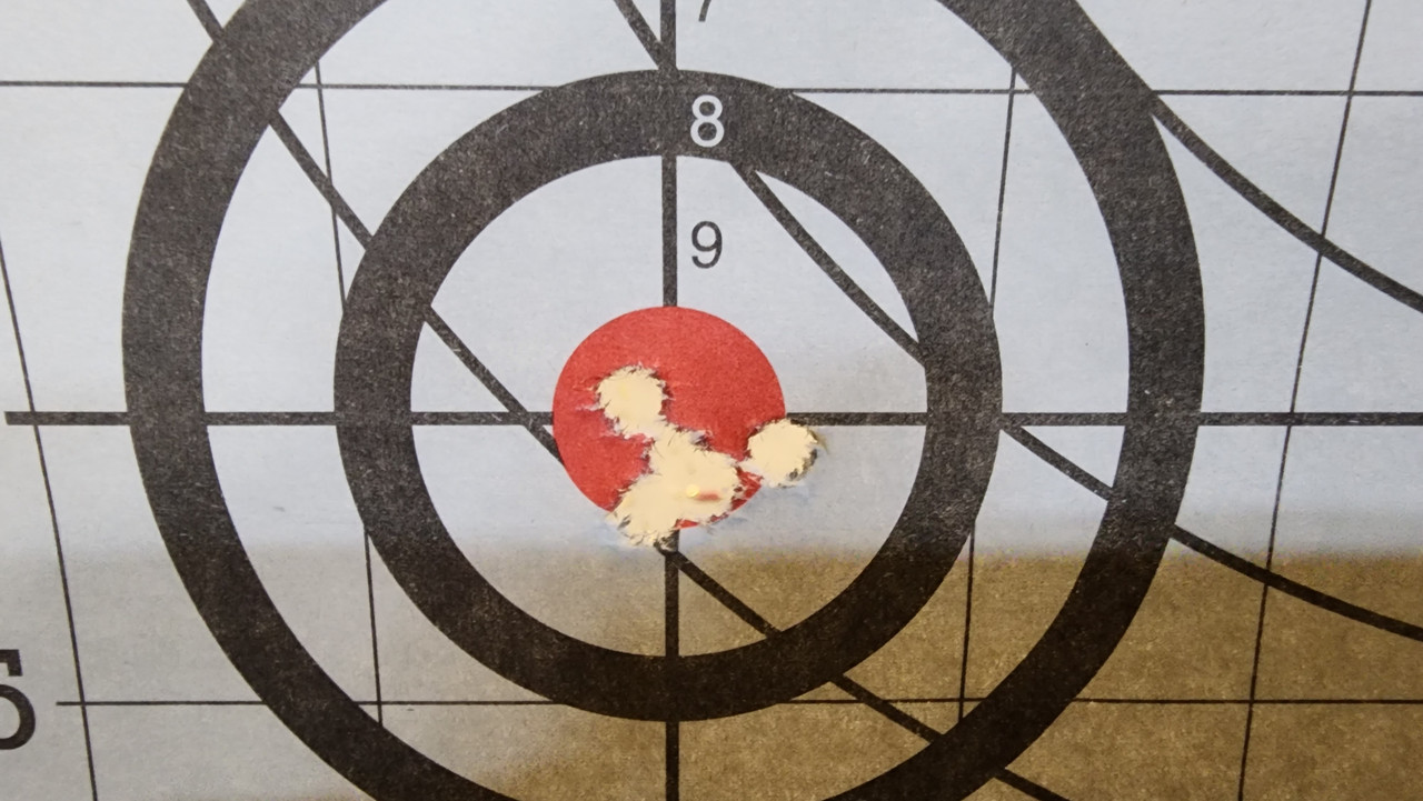

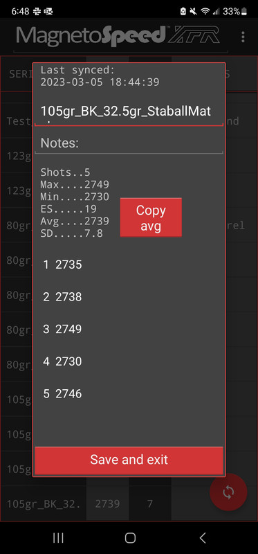

32.5gr
[Image: Screenshot-20230305-184813-XFR-REV2.jpg]
[Image: 20230305-174731.jpg]
Brass showed nothing at all. My past experiences with the powders I have on hand is telling me to try power pro varmint next.
Worst group was .420 MOA, best was .170 (5 shot groups)
Getting hard to determine if it's ammo variation or me when it gets in the .2s as I'm not very good at this. 22" criterion 1:8 hbar ar15.

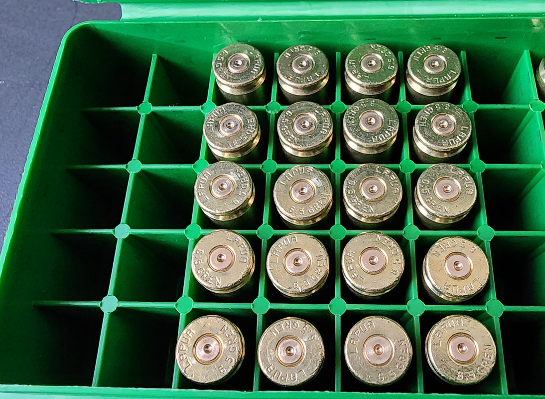

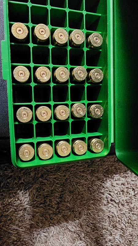

None. Nothing at all. Very surprising considering much more powder and I'll be in the case neck. I tapped the side a little to settle the powder and saw no growth after seating so if it's compressed, it's only a little... but still visually it's in the holy crap area looking in the case before seating. It's why I didn't run to 33gr as planned, i feel like I'm out of space.
[Image: 20230305-194624.jpg]
Bottom to top is low to high charge.

Zeneffect Wrote:None. Nothing at all. Very surprising considering much more powder and I'll be in the case neck. I tapped the side a little to settle the powder and saw no growth after seating so if it's compressed, it's only a little... but still visually it's in the holy crap area looking in the case before seating. It's why I didn't run to 33gr as planned, i feel like I'm out of space.
You can see a progressive flattening of the primers with charge weight increase there.
Looks like your velocity and groups are where you want them to be. You could pick a load based on brass life or velocity and be happy mass-producing it.
2652
2684
2719
2739
I would agree, primers are starting to flatten, but not to any degree I would be concerned about based on known loads that are within pressure limits. I think with this powder and bullet it's harder to get yourself into any real trouble. Going to do a work up with ppv next. I want to max the velocity so I can keep them above 1750fps at 550 yards.

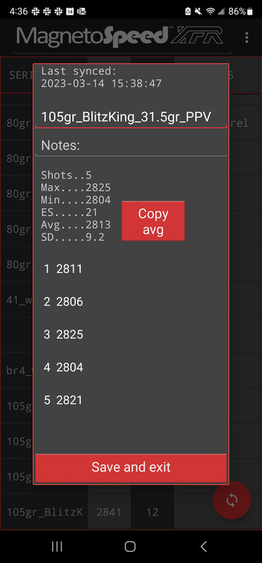

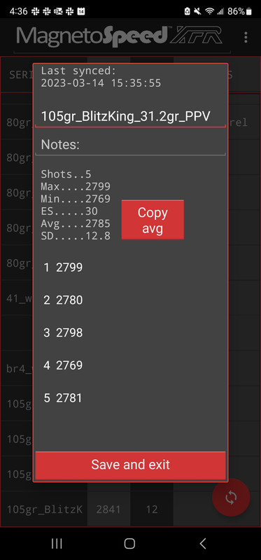

Sierra 105gr Blitzking data - Zeneffect - 03-14-2023
br4 and crimp did nothing
PPV was very interesting. have chrono data, will share once I pull it. Just shy of 2850fps average at 31.8gr.
Edit
[Image: Screenshot-20230314-163638-XFR-REV2.jpg]
[Image: Screenshot-20230314-163645-XFR-REV2.jpg]
[Image: Screenshot-20230314-163653-XFR-REV2.jpg]
[Image: Screenshot-20230314-163700-XFR-REV2.jpg]
22" barrel, but switched to a uintah bolt action upper. Either at or over pressure for ar15 platform I would imagine. Primers starting to look a little flatter than I would like to continue much further.
Sierra 105gr Blitzking data - Zeneffect - 03-15-2023
[Image: 20230314-182421.jpg]
Low to high is right to left. Need to buy another few hundred of these pills as I think ramshot tac might be pretty good too and I'd like to continue testing.
