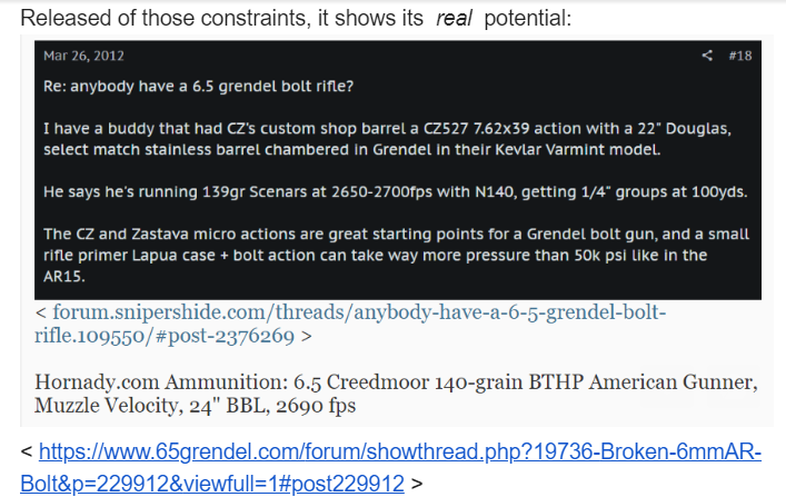

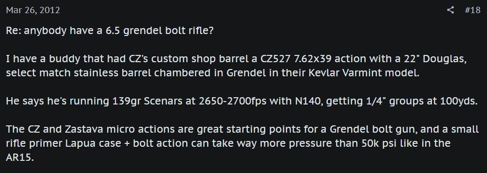

< forum.snipershide.com/threads/anybody-have-a-6-5-grendel-bolt-rifle.109550/#post-2376269 >
Hornady.com Ammunition: 6.5 Creedmoor 140-grain BTHP American Gunner, Muzzle Velocity, 24" BBL, 2690 fps

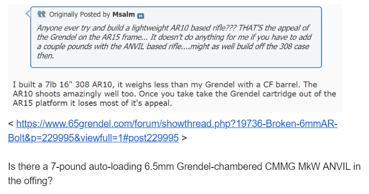

Broken 6mmAR Bolt - Msalm - 05-02-2019
Anyone ever try and build a lightweight AR10 based rifle??? THAT'S the appeal of the Grendel on the AR15 frame... It doesn't do anything for me if you have to add a couple pounds with the ANVIL based rifle....might as well build off the 308 case then.
Broken 6mmAR Bolt - A5BLASTER - 05-02-2019
Msalm Wrote:Anyone ever try and build a lightweight AR10 based rifle??? THAT'S the appeal of the Grendel on the AR15 frame... It doesn't do anything for me if you have to add a couple pounds with the ANVIL based rifle....might as well build off the 308 case then.
Totally agree the CMMG frames have no appeal to me at all.
Now if someone from this board had a spare ar10 bolt laying around. They can send it to me and I can take some measurements and see if it would be possible to machine it down to fit a standard ar15 bcg.
Broken 6mmAR Bolt - centerfire - 05-02-2019
I built a 7lb 16" 308 AR10, it weighs less than my Grendel with a CF barrel. The AR10 shoots amazingly well too. Once you take take the Grendel cartridge out of the AR15 platform it loses most of it's appeal.
Broken 6mmAR Bolt - SHORT-N-SASSY - 05-03-2019

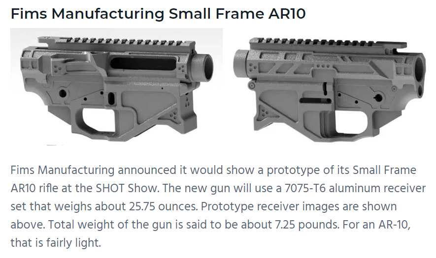

Broken 6mmAR Bolt - SHORT-N-SASSY - 05-04-2019
And, the Fims Manufacturing Small Frame AR10 rifle: 7.25 lbs ---
[Image: Fims.png]
< http://www.gunsholstersandgear.com/shot-show-2019/ >
Broken 6mmAR Bolt - A5BLASTER - 05-04-2019
SHORT-N-SASSY Wrote:And, the Fims Manufacturing Small Frame AR10 rifle: 7.25 lbs ---
[Image: Fims.png]
Awesome. But then again it's not usable with the cmmg grendel bolt at ar15 mags. So it's useless in this discussion.

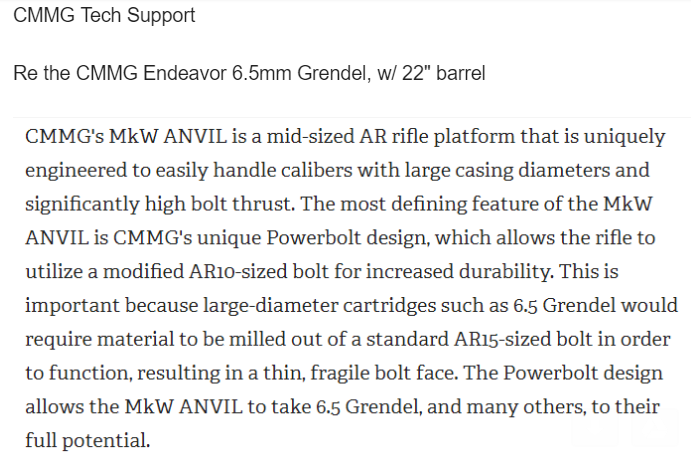

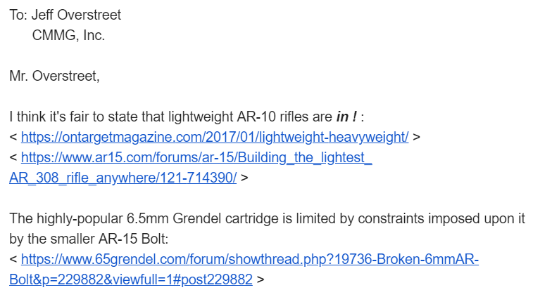

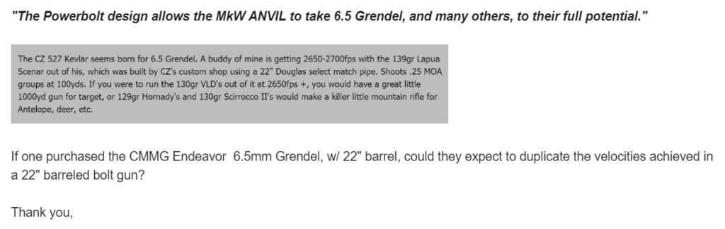

Under the heading, CMMG POWER BOLT, I today sent the following email-request to CMMG Tech Support ---
[Image: Endeavor.png]
[Image: Endeavor-A.png]

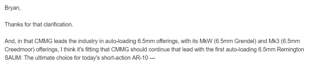

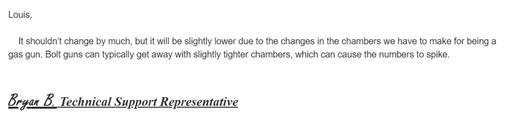

Broken 6mmAR Bolt - SHORT-N-SASSY - 07-20-2019
I today received this Reply:
[Image: Louis.png]
And, my response:
[Image: Bryan.png]
[Image: Bryan-A.png]

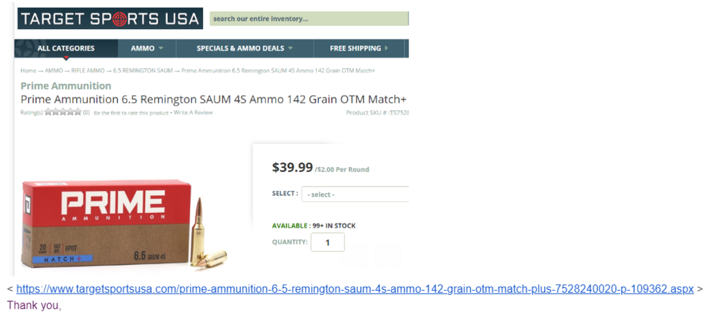

< https://www.targetsportsusa.com/prime-annunition-6-5-remington-saum-4s-ammo-142-grain-otm-match-plus-7528240020-p-109362.aspx >
