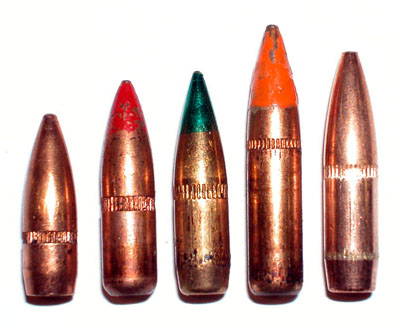

That could be a short-sighted and costly error. For example, M855 Ball only needs a 1:9 rifling twist, but M856 Tracer needs 1:7 twist. If all 5.56mm weapons had been fitted with 1:9 twist barrels to stabilize the Ball round, it would've been necessary to do a very expensive retrofit to be able to use Tracer ammo. It's called, PLAN AHEAD. Smile
Quote:Speaking of which has the 5.56 tracer been modified since the M193 was developed?
Yes, most certainly. M196 Tracer was adopted for use with M193 Ball, and replaced by M856 Tracer with adoption of M855 Ball.
Below, l. to r.: M193 Ball; M196 Tracer; M855 Ball; M856 Tracer; Mk262
[Image: rounds.jpg]
