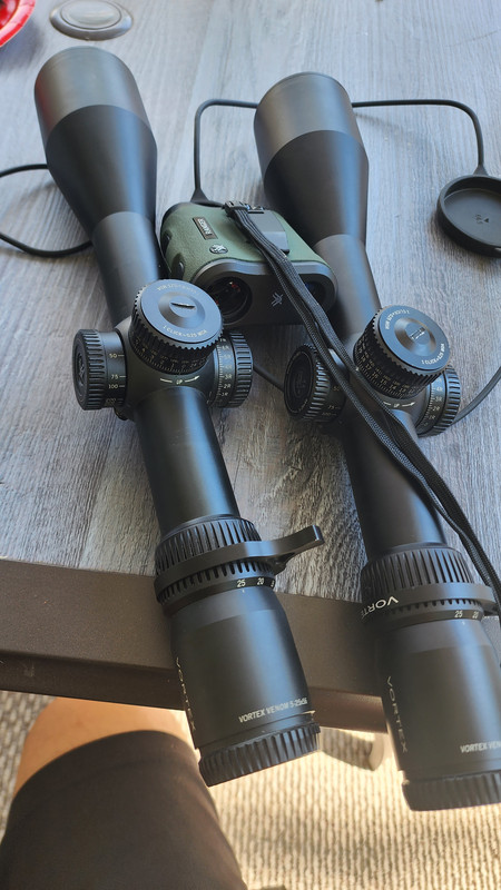

Done with vortex - Zeneffect - 07-23-2023
Checking on some trees today, 388 yards per range finder and it won't focus. Inside of 200 I can get focus, beyond 200 nope (physical yards... not what's on turret, the turret has never been right) I have another of the exact same scope without this problem. Scope is poopoo, it needs to be set to infinity just to start to get the outlines of shape. Decent glass while it works but I need it to work all the time and never worry about it. Mk5 or nightforce nsx might be what I'm looking for. hold .5 moa, pull the scope, club a baby seal to death with it, slap it back on and expect no more than 1 moa shift should be the standard.
I have no brand loyalty. I need things to work as expected when I need them to. Maybe that's a pretty hard ask for commercial grade equipment.
This is a picture of a palm tree 87 yards from where I'm standing (per range finder)
[Image: 20230723-111451.jpg]
These are the 2x venom 5-25x56 side by side
They are both focused on that tree, specifically the white flowers on it.
[Image: 20230723-111403.jpg]
Pick the bad scope. Also I never really noticed before but one is way brighter than the other.

Done with vortex - Zeneffect - 07-24-2023
I know it failed because of observation at range during a match, then again today after comparing against reference scope of same model and re-testing both known good and bad distances to see where parallax sits in relation to its range of motion. Both stop at the infinity mark so I'm presuming the range of adjustment vs range of motion should be the same.
I'm interested to know also... though when the erector went out the only reason they listed was "internal damaged part"
I'm really leaning towards the nx8. I can't afford the 3k actar, but the nx8 8-32x56 is right in that goldilocks zone of features, glass, and price. Still doing my research and will visit a few stores to try some hands on before deciding then buying at best price I can find.
Also... from my point of view, though I can work with 1 scope out of the 2, a target closer than 100 yards in shouldn't be over 100 parallax marking on either scope... so they are both not in spec.
Well... very much like measuring top dead center on an engine, I can measure the degree of rotation needed to focus on a static object at a known distance. I doubt I will be within 30% of each other which is concerning. I think that should give me the relative data to show that one is clearly not like the other (pun). When sub 90 yards is past 100 on one and past 250 on another, and I can't focus on a ~400 yard target with one of them.... something not right and the difference between the 2 on just the turrets is enough. I'll leave it ip to vortex to figure it all out. Venom is made in China btw... can't say I recommend them.
