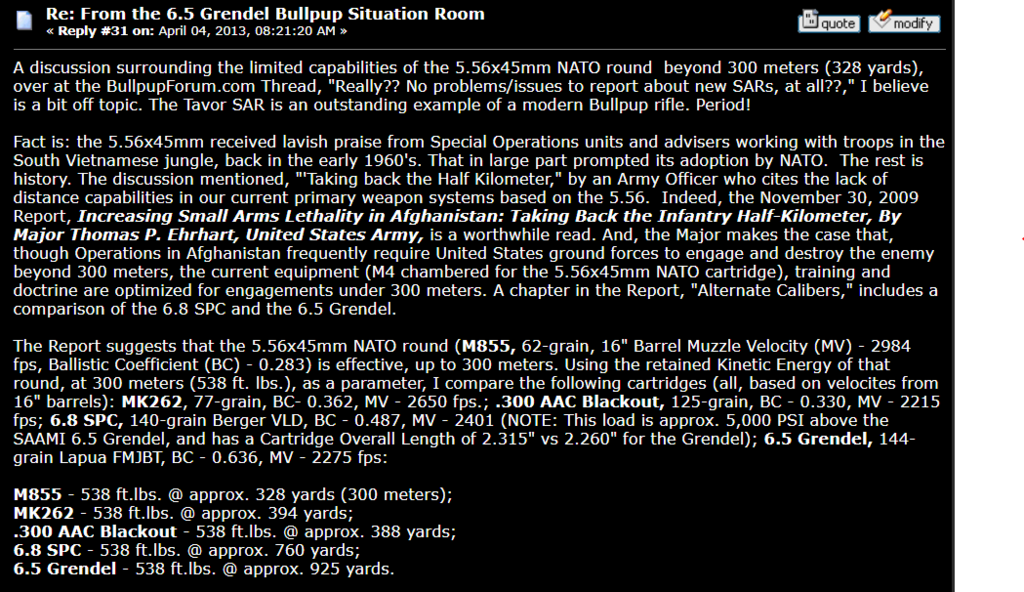

Maximum Effective Range - SHORT-N-SASSY - 05-10-2019
[Image: effective.png]
< http://bullpupforum.com/index.php?topic=1060.msg22280#msg22280 >
