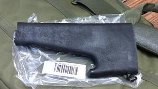

    I would like the thoughts on the Fixed STOCK being used on the 6.5 Grendel 24" barreled upper vs the Adjustable butt stock pros and cons? I'VE got a Choate fixed butt stock that I can use. The LR is a fine butt stock with all its adjustment. Has the side anti rattle set on it. The LR plus the SPS adj plate with the Kick Easy recoil pad adds much weight to the gun. The adj cheek is still really to high on the lower position for me to get a comfortable cheek wield. Another issue I have found is the charging handle will catch on the front of the stock or depending on the position it will hit the cheek riser.

      With this change comes the tube change also. Choate told me the fixed tube with the different buffer weight should not be a problem. I'm thinking the fixed A2 BUFFER is heavier and I know the spring is longer due to the length of the tube. Wonder if this will be another working out issue with weight? NON adj gas block for now.
      But I agree on the wobble. But the LR will lock tight. But still a large butt stock. As this gun is set up it's going to be a bench type gun. Not a carry around in the woods. Lop sized up to the position I have the LR is about the same. Planning on using the SPA and kick easy butt pad? The pad that goes with this stock is the regular hard A2 pad. Not that really matters but I like the soft butt pad for shouldering and what ever recoil.

                    Buffer tube arrives today. Ill soon know how this works out. If not happy with the change it will go on the AR parts shelf. All good feed back and thanks all! Not going to be a hunting gun. I have looked at many nice fixed stocks offered. MagP has some nice ones plus other brands. Factory direct and local was hard to pass up on the price. Normally Choate has blems which you can not tell the cosmetic blem discounted low or in my case some times free. This butt stock was not a blem.

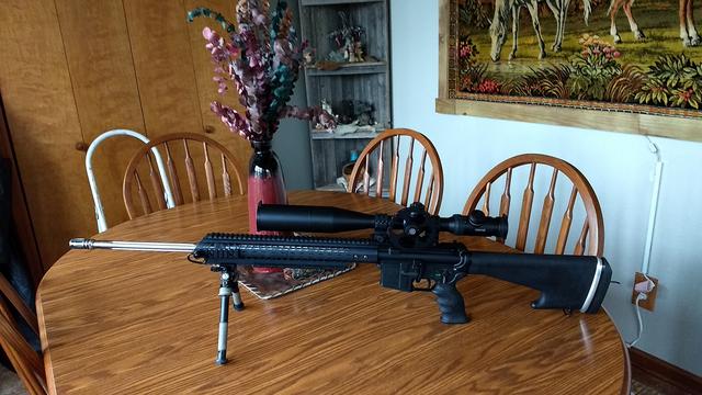

                      I got time to install the fixed stock. The SPS adj butt took some slight repositioning of the attachment holes but worked out sweet.
                      Not had a change to do any shooting but the check weld and eye to scope seems correct. No charging handle issues. Lop is good. Shoulder's very good.
